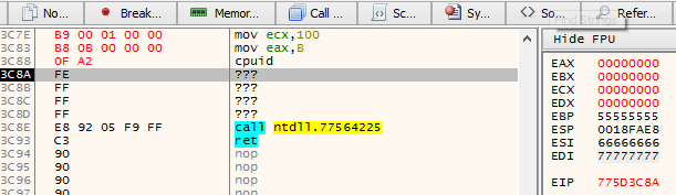

i found this "feature" , if you do:
MOV ECX, 100h
MOV EAX, 0Bh
CPUID
You reset all your registers and you get only a value in EDX, where is showed your current core...
Is that normal??
I have a i7-2600, can someone with different CPU try if have same results?

On my PC, it clears EAX, EBX, ECX, EDX (which are registers that CPUID puts results in according to the documentation). It doesn't clear any other registers:
