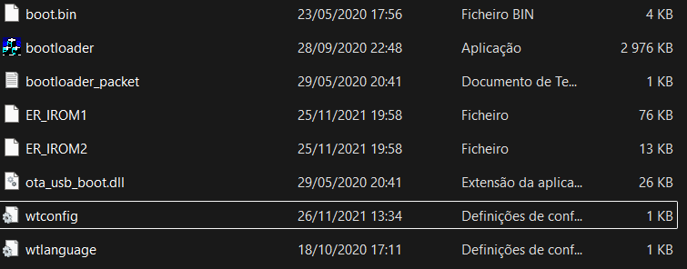

In their software there's a updating app and likely firmware separated from it, is it ok to ask if someone here could maybe do it for me??
All I wanted was to have more pre-defined colors added and the addition of dimming the ring of light with like FN+PageDown.
The checksum's of all files also seem to be in the config file of the updater app:
[PRODUCT]
ic_type = MWV602
program_type =multi_file
[BOOTLOADER]
Bootloader_VID = 0x2EA8
Bootloader_PID = 0x0001
Bootloader_type= USB
ENCRYPT_KEY    = 0xffffffff
Bootloader_Info = vid_2ea8&pid_0001
[APPINFO]
App_Info = vid_2EA8&pid_2122&mi_01&col03
App_Dev_Type = 0  ;1:mouse,0:keyboard
App_Report_ID = 4 ; fixed 4 now
App_Dev_ID=0x0f04
[HEX]
boot_name =boot.bin
app_name =ER_IROM1
data_name =ER_IROM2
merge_name = program.bin
[BOOT_SIZE]
602boot_size = 0x1E00
905boot_size = 0x600
[DATA_START_ADDRESS]
boot_address =0x0
app_address =0x2000
data_address =0x1A000
[SETTING]
bootloader_upgradable =1
application_upgradable =1
data_upgradable =1
[LOCAL_CHECKSUM]
boot_checksum =0x18C959A7
app_checksum =0xA251C166
data_checksum =0x22269921
merge_checksum =0x98BE01E0
[IC_CHECKSUM]
boot_checksum =0x422F1A50
app_checksum =0x2670F275
data_checksum =0x333D2A3C
merge_checksum =0xA89D3DE6

hard to know, on the update .cfg file like shown above says ic_type = MWV602 but there's not even info on it; but it's likely something ARM, no idea what ☹️
I'm not even 100% sure but the firmware is likely ER_IROM1 and ER_IROM2 without any file type.
And to check visually it's likely on top of the keyboard, I would have to disassemble it and remove all the 100+ keys 😱
